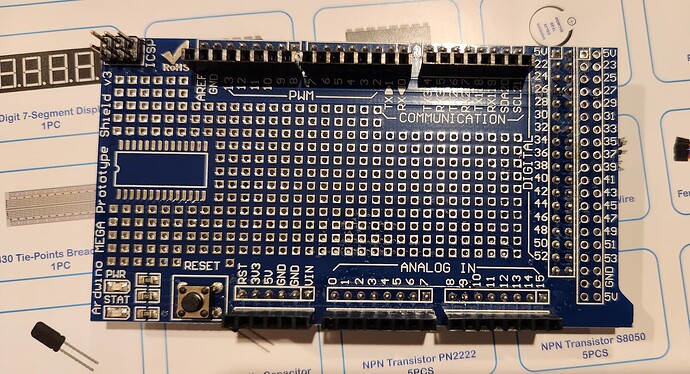

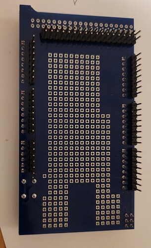

Also my mega kit came with a different shield. It's a little unclear how the traces are organized.
  • These are Male Headers at .1” spacing.
  • You can buy Female Dupont Connectors.
For that shield, it looks like the header pins are connected to the holes next to them. If you solder the wires to those holes it will result in more reliable connections. I don't think that the second shield that you showed has those connections between headers and holes.

I've decided to use this as it came with the kit:
I
I need to contact several together especially for VCC and gnd. Strangely the above lack ling distance traces. To make longer traces, should I simply bridge solder? Or do I need to affix jumper to wires??

For connecting pass together for a trace, I am thinking I should use a thin strand of copper wire to help guide the solder.
Look at @LarryD pics in post #8 for ideas.
I like using 28AWG solid hookup wire for low current runs such as below. It's easy to work with when using quality strippers.
