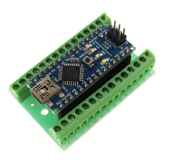

I didn't even know there were any Nano shields.
kenwood120s:
There are not many, but some
https://opencircuit.nl/Product/11183/Arduino-Nano-kroonsteen-shield-DIY
macpeterr:
We live and learn!
But that particular one's just a means of bringing the wires out to terminals; are there any "real" ones with functionality those for the Uno/Mega form?
