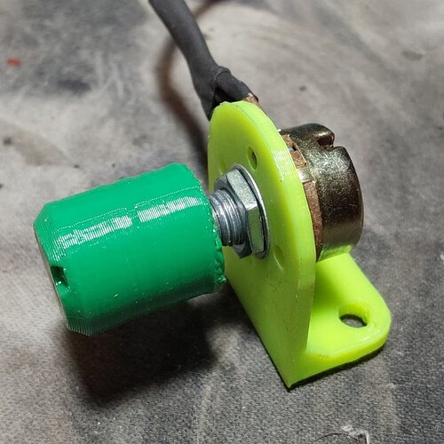

When I get a module that won't take #4, I 3D print a bracket that will.
