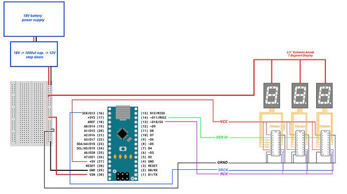

Good morning,
I was wondering if anyone might be able to take a look at this and tell me what I might be doing wrong. I believe I am within the realm of necessary voltage and resistance, as I successfully hooked up a single TPIC6B595 on a breadboard with resistors and necessary voltage, and was able to control one of these large segments just fine. Now that I have scaled it out and daisy chained registers, I can't seem to control them.

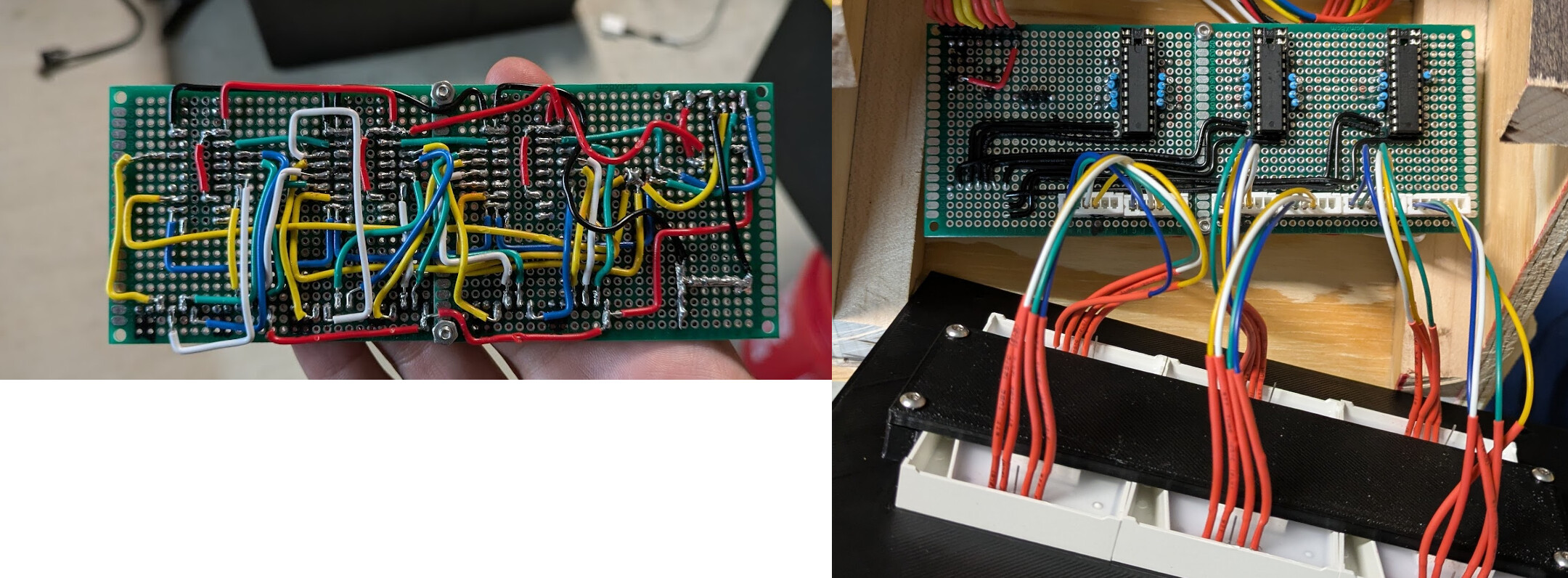

I have hand wired this whole portion of the project (its not pretty), so I fear I may have crossed some streams somewhere, resulting in its uncontrolled behavior; however, I wanted to post here as a sanity check to make sure my diagram on paper seems logical.

Only a moment. I see resistors in the pictures, looked because I missed them in your circuit drawing.
The wiring looks very good for the method you have chosen.
I woukd try removed the two distal shift registers and see if one display unit works like it did on the breadboard. You can put one shift register in only, try each slot by jumping the serial signal over the missing shift register(s) for the other two when they are tested solo.
I don't see any capacitors near your ICs, it is essential to place a 0.1 uF ceramic cap across the power lines as close as possible to each IC.
Lastly, remove all chips and disconnect eveything, get out your ohmmeter or continuity checker and confirm the wiring. I use a highlighter to draw over a large copy of the schematic.
Test until you may find shorts between signals, or missing/wrong connections.

The only thing I can see which may cause an issue is the lack of 100nF ceramic decoupling (aka bypass) capacitors on each of the TPIC6B595s.
From the datasheet:
It should be fine driving the 5V supply of the from the Arduino 5V pin:

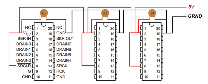

Thank you all for your time and informed suggestions. It does seem to be the general consensus that I have forgotten the 0.1uf capacitors near the registers. I have a bag of 100nf caps here and will give that a try here next.
Given that my current wiring of these registers looks like this:
Where would the best place to put these capacitors at? I understand they need to be close to the VCC of the chip, and connected to ground. Would something like this be feasible?
I think I am more concerned about the junctions of combined 5V right at the VCC pin, and where the capacitor needs to be within that circuit.
Or would something simple like this be a possibility since there is room on the top of the pcb?

  • You should also add a reservoir 100uF capacitor to the 5v line where it connects to the display PCB.
I'd also check the ground connection.
Your diagram indicates it runs through the arduino
The digital ground should connect directly to the PSU as a "start point"

This is a good point that I had not considered. I think I was mentally assuming all ground connections can merge and are created equal, but I did not consider passing in/out of the arduino and/or ground looping it.
My drawing is a little misleading, as I have the arduino side of this on a breadboard currently. Here is what it actually looks like, so I may have inadvertently grounded it correctly without thinking about it lol.

Because the power and ground to the TPIC6B595 are on opposite pins then the very best way is to use a surface mount capacitor. You can do this by cutting a thin piece of track between the holes with a scalpel or hobby knife, and bridging the gap with a surface mount capacitor. Like this:-
  • Or in the OP's case an SMD capacitor on the bottom side soldered to the Vcc pin, the other end to a PCB pad then use a wire to the GND pin next door (maybe .1" away) .
I thought that is what I showed. The view was the under side or track side of the board.
  • Yes you did.

That does seem like the ideal solution with the SMD cap; I think if/when I end up having a PCB created, I would go that route. I only had the classic caps in my bag of parts, so I gave that a try last night; unfortunately no luck.
Basically all of the lights stay on, so at first glance it does not appear that any communication is happening with the registers. I need to do some single register testing, and probably breaking out the multimeter to do some tracing.

It wouldn't hurt either to take a magnifier (10X at least) and a bright light and inspect all the connections. There may be a cold joint or bridge between two points that shouldn't be connected.

Those leads are way too long to be effective.
