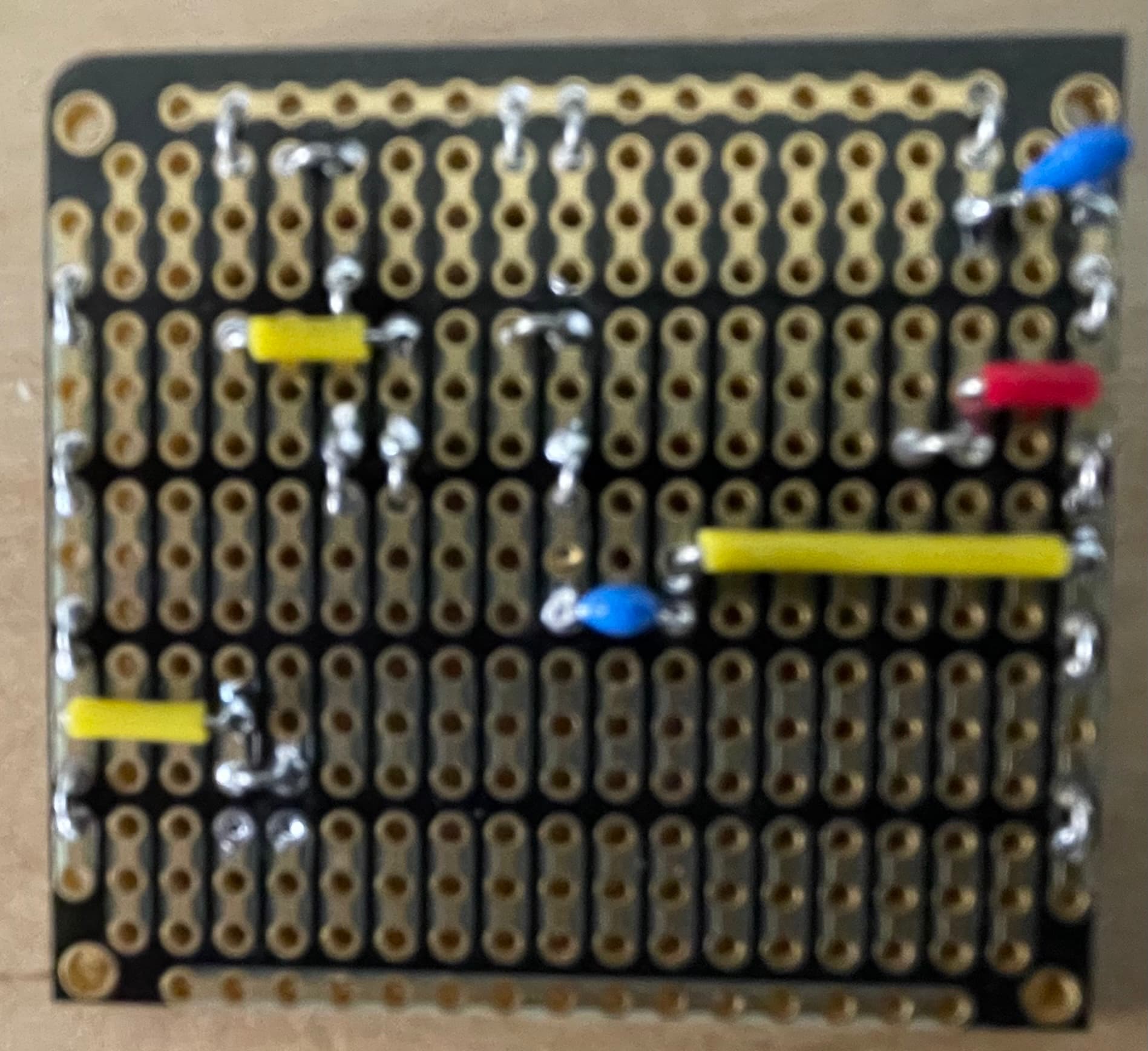

I like to start with the power and ground connections and ring them out with a continuity tester before installing any components. I then follow up with the rest of the wire “traces” and low profile components. Then I install the taller components in what ever order feels right at the time, double checking my wiring as I go.
